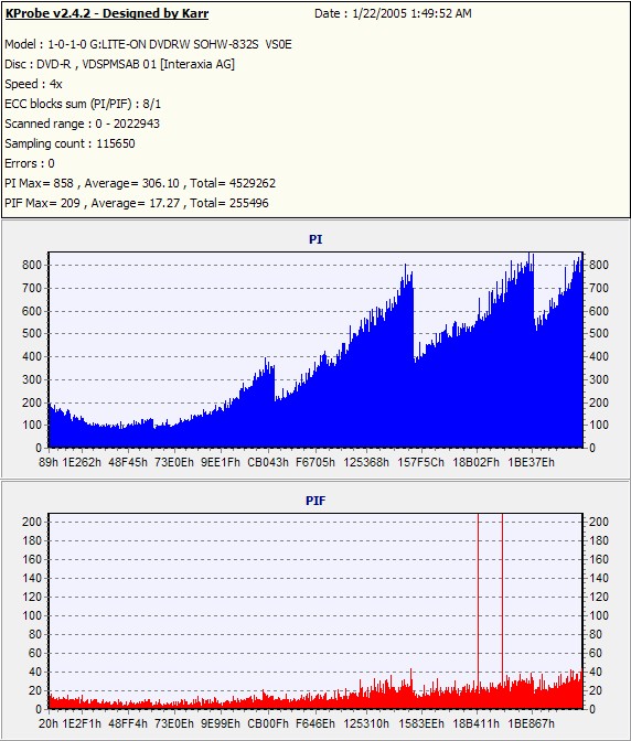

Ok, this stuff is wierd. Sometimes I get scans like this, and I really dont know why. This is a rated 4x scan. At max, it scans much better, though. I'll post both.

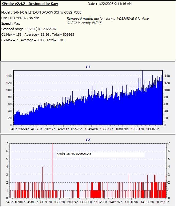

Here is the max speed scan.
NOTE: D'oh! I thought I saved the original, but it looks like I only saved my copy where I had removed the PIF spike. (It had 1 spike at 96). Just so everyone knows..

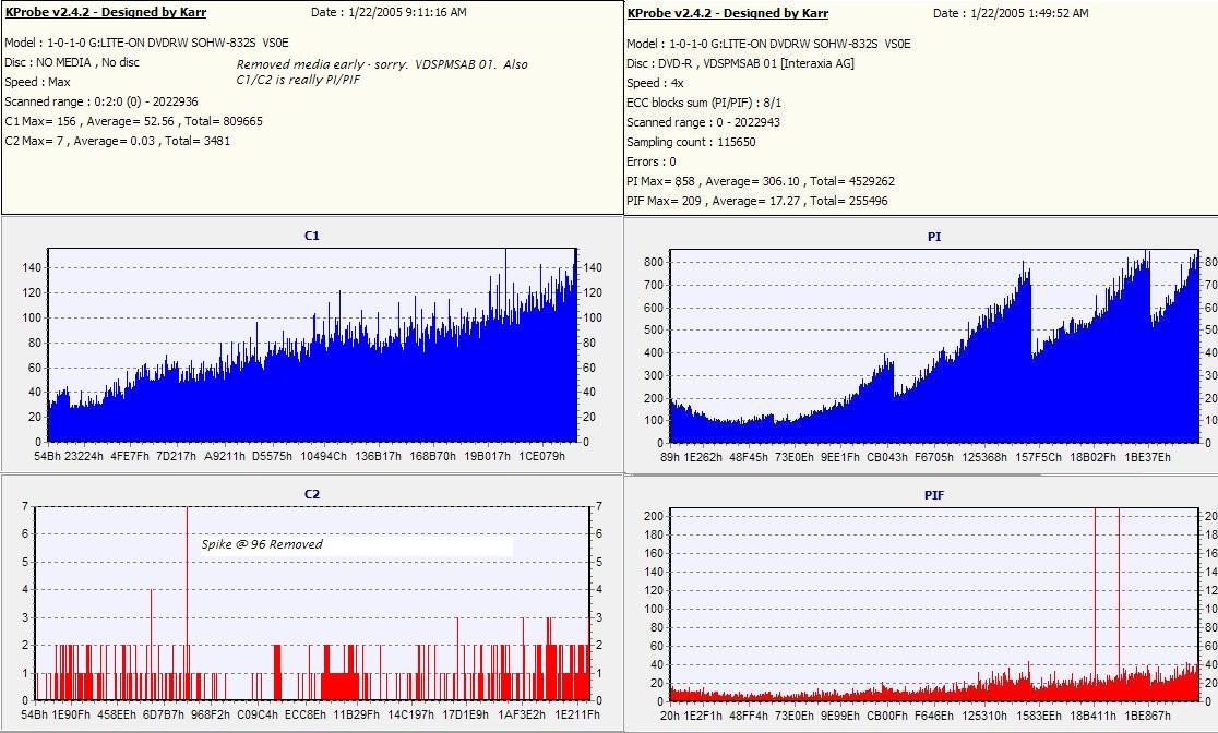

Here's the side-by-side.

I've used this stuff before, I'll post a scan if I have one saved or if I can dig up one of these discs :P
I wouldn't trust those numbers on the max test, 4x is pretty well the standard for testing and getting reliable results (yeah I know you already know this though
). Your 4x test looks marginal, a good player would probably play it ok, but a pickier player would probably choke alot.
Well known crap. No surprise here either.
